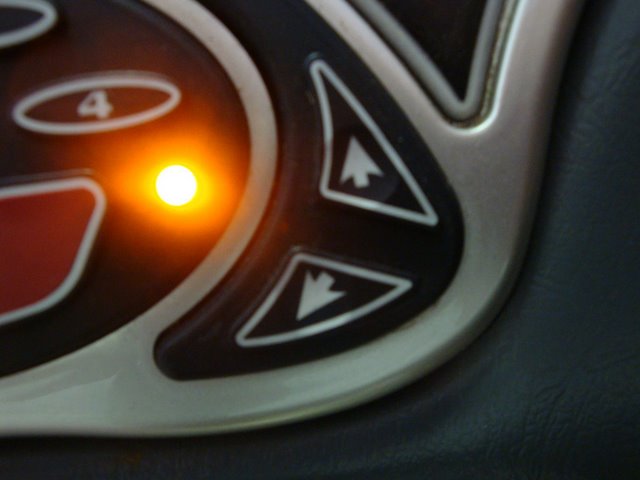

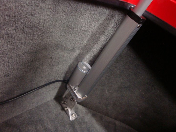

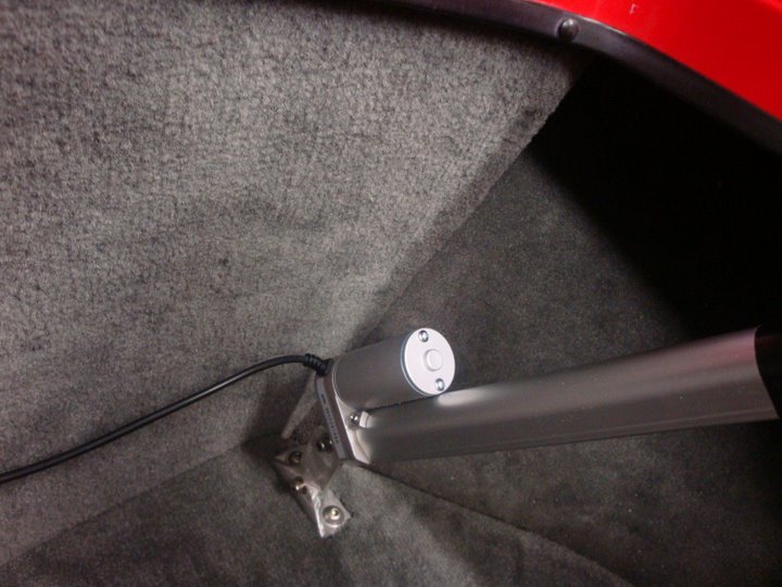

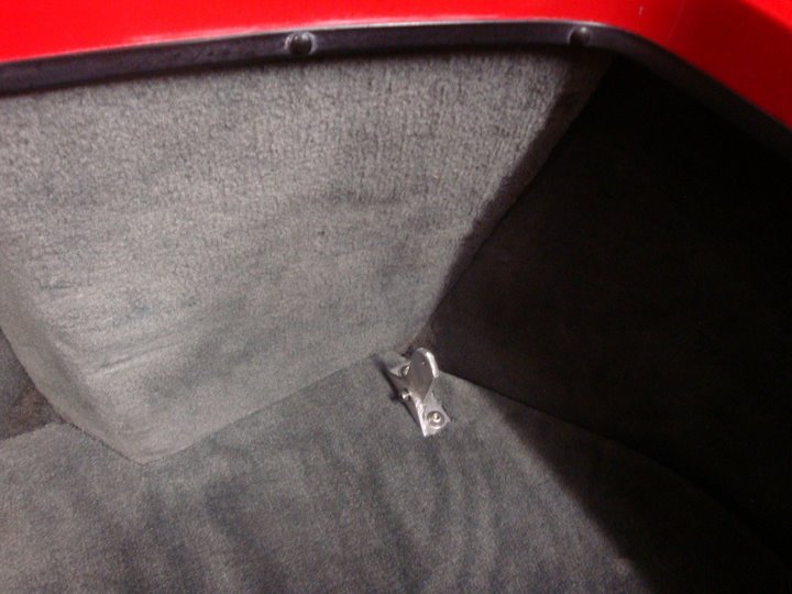

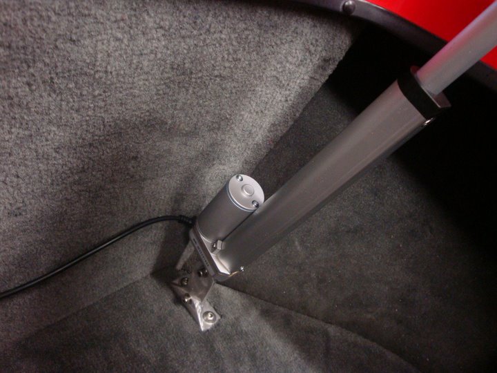

I picked up a Select Products linear actuator from Brian at Liqued Trends. I had never done one of these actuator installs. It was pretty easy. The linear actuator works with a electronic control box that makes the actuator go up and down. It's a simple install. You figure out how much throw you need the actuators come in assorted lengths. All I had to do was make a mount for the bottom of the actuator to mount to the bottom of the trunk and then mount the top of the actuator to the stock gas shock mount on the trunk. I want to find the Dash mounted button wires (first photo)that I can tie into the controller so I can open & close the trunk from the dash.(So if you know what wires I need to tap into please let me know) Right now it works from the stock trunk release.
