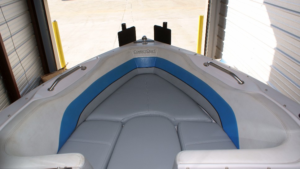

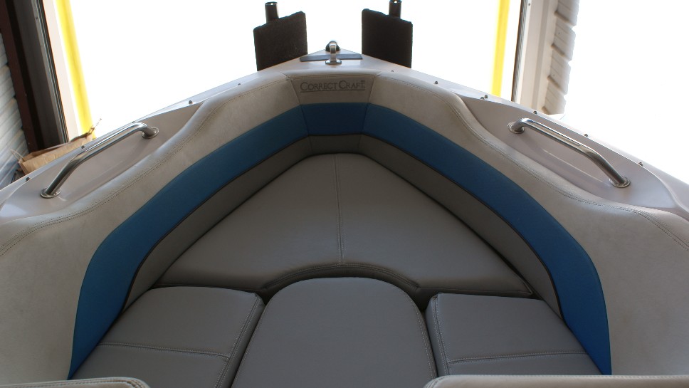

                        Just test placed my bow cushions (have not tacked on the hidem yet, so some re-doing is still possible). As I suspected, the nose cushion's seam is not quite straight. It travels from right to left as you go toward the tip of the bow. It's pretty slight, but noticeable to me. I noticed this when putting the cushion together, but could not get it to fit any other way. Unfortunately, I did not take any pictures of the top of the old cushion, just the bottom, although I seem to recall it looking kind of the same to me before (i.e., a little off center). Anyone else have any pictures of their bow for a sport or air late 90's or early 2000's? Or, could you let me know if your center seam appears to line up perfectly with the lift ring on the bow or not?
                        Note, the back rest is still the old vinyl. I have not gotten to that yet.

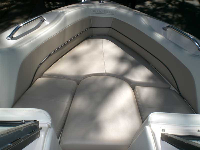

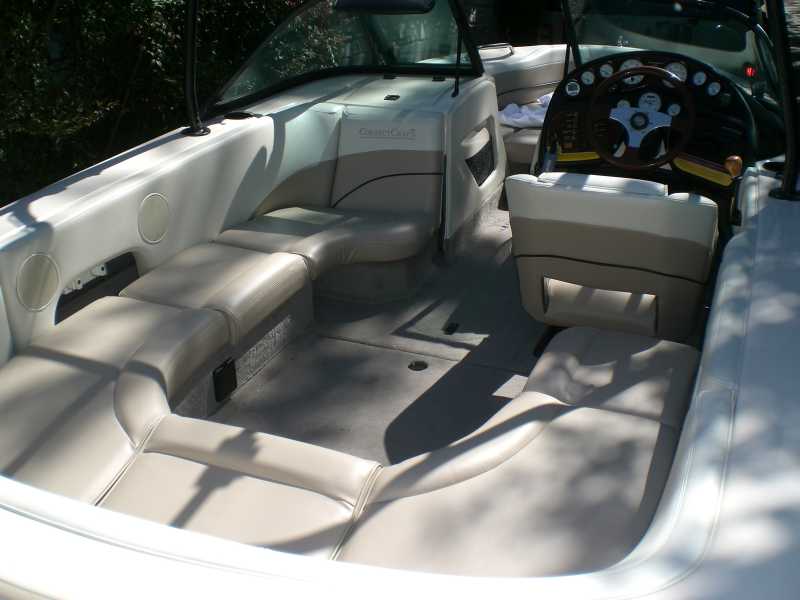

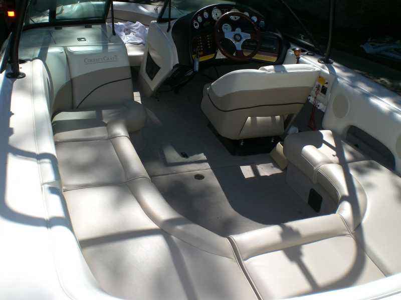

                              Here are a couple of shots I took yesterday of my new skins. Sorry about the bad lighting, it was a bright morning with many shadows from the trees.

                                Looks awesome David. I think your center seam on the bow cushion is a little straighter than mine, but it's hard to tell from that angle. I think I'm going to live with mine as is. It is really close to perfect, and with the bow being asymetrical anyway on these boats, I'm not sure it would ever look perfect.
