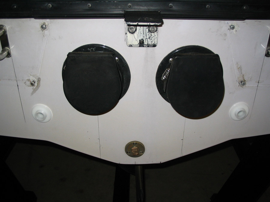

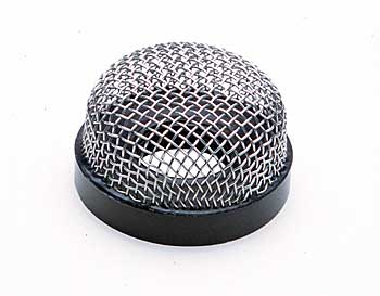

      Originally posted by Sinkoumn
      WakeSlayer, are your 'screened thru hulls' the scoop style? I am really debating on whether or not I want to switch over to the Ballast puppy style pump, the system I have now is all aerator pumps (two on each bag) and works well enough with the helm controls that I just have a hard time dishing out ~$400 for something that isn't broken :grin:
      Sink, my thruhulls are under the swim deck. I don't feel the need for the scoops. The puppies fill fast enough you do not need to use the time riding to your site to fill. The other side is I can drain them while running. I understand the idea of not wanting to dish out the dough, but once you put them in you will be glad you did. These work far better than well enough.

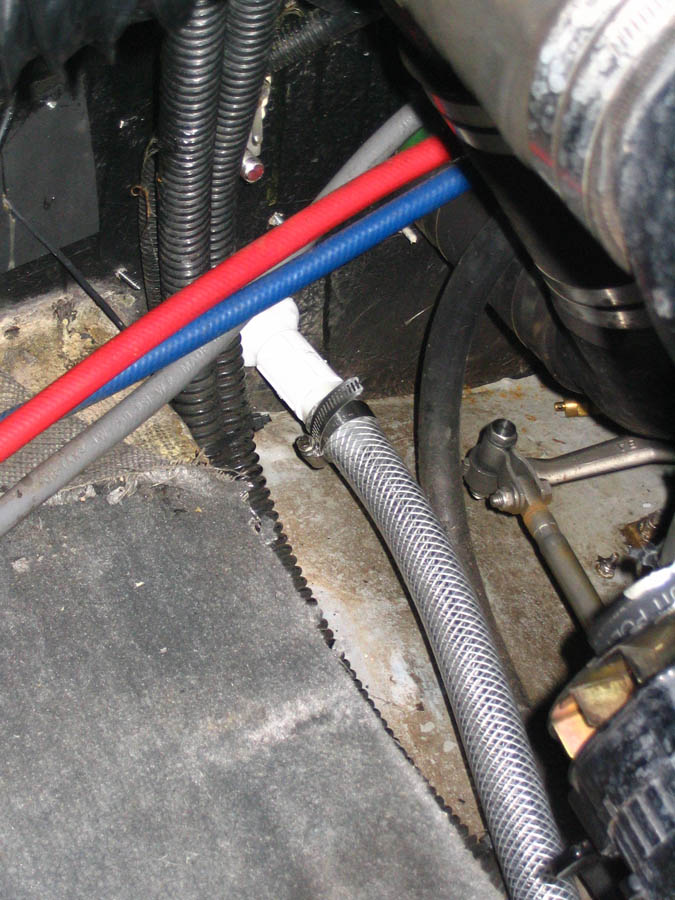

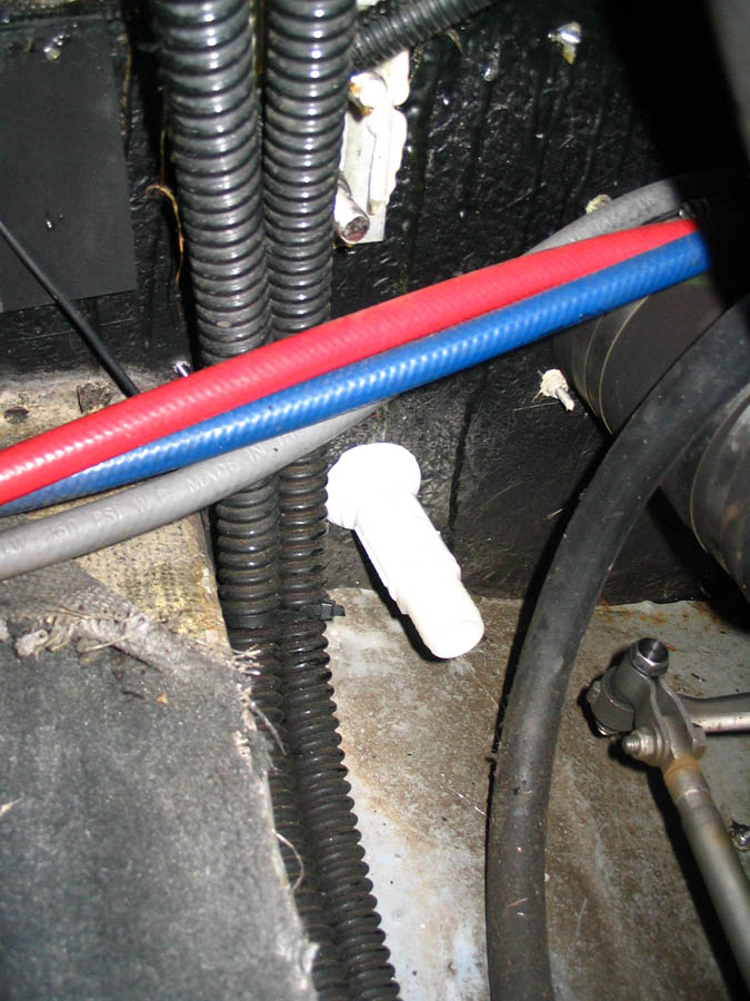

        Wakeslayer, Do you have any pictures or your through hall install from the inside of the boat? I don't have very much room in there and like the way you ran yours out the back.

          #49
          N20
          Here you go. I cannot attest to how much room you have because I do not have mufflers in my boat. Too much motor in the way.

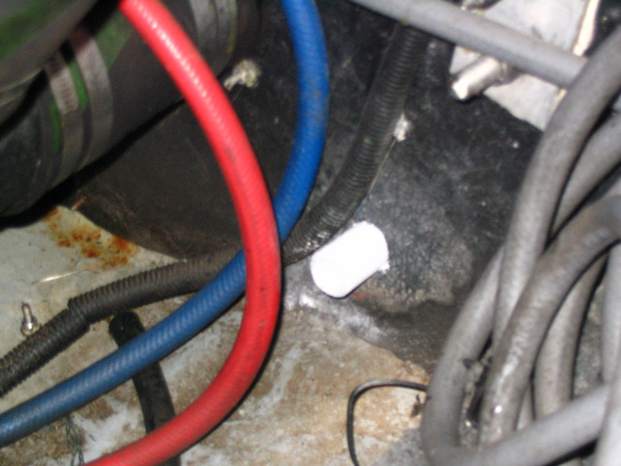

          • N2Orbit
            • Apr 2008
            • 72
            • Lake Milton, Ohio
            #50
            Originally posted by WakeSlayer
            N20
            I have the same tight space to work with that you had. My Super Air is Python powered.

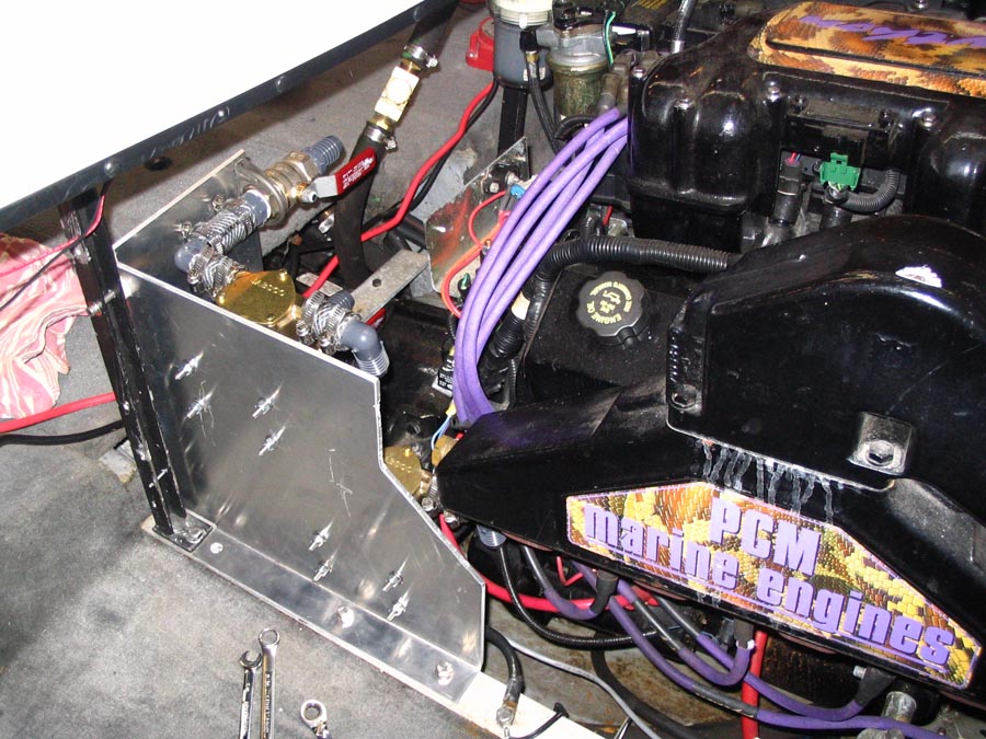

                Well then, you see what I am saying !!
                Here is another with the line hooked up.
                Thought I would show you a pic of the pump block I had my neighbor make for both me and my friend who has the twin to my boat. He made it for like $90, and it makes the install very clean. He would be glad to make another. If you are at all interested let me know. Or PM me and I can email you the diagram for it.

                  Are any of you guys running into any issue with the engine compartment getting too hot with the floor to (almost) hatch partitions? Basically I have my partitions setup and installed, and will be setting them right against the engine - basically identical to WakeSlayer's. But looking at it, will the engine compartment, specifically around the engine, be fine with the partitions getting in the way of the air flow from the side ram's on the sides?
                  Probably a dumb question, but just wanted to double check before I add the carpet and metal plates to the partitions.

                        #56
                        Ahah, sorry; but with the 750's and partitions, any problems with the engine compartment getting too hot? Or no?

                          #57
                          I dont have partitions that go all the way up, but my bags almost do and I have no issues what so ever. I planned to build some this coming winter that are two piece so I have some storage on top of bags when they are full. I cant imagine having an issue with overheating as the new boats are done that way and they have no issues at all!

                            #58
                            No issues.
