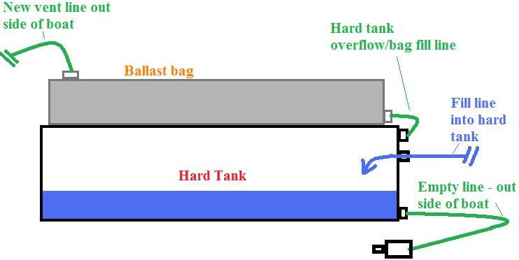

    in my 05 i plumbed in wedge sacs on top of factory tanks. i removed the carpeting, ran a line from the oem overflow to the bottom of the bag, then made a U shaped hose(like kitchen sink) that runs behind the tank at the aft of the boat and that is now the overflow. depending on your pump you have to buy plugs at home depot for the empty hole(not overflow) i've been using mine for a year now and i like it. you have to blow the water out of the overflow before emptying though.

        Here is what I was thinking - or thought what everyone else had done (basically identical to your setup gride, sans the U-shaped hose). I have three lines running to my hard tanks - fill, empty, and vent. The emtpy and vent have their own thru hull exiting the side of the boat, so I was thinking of just taking the old vent line and connecting that to the bag, then just adding the new vent line off of the top of the bag and going out the thru-hull on the side of the boat. Then the fill/empty would just be run off the hard tank like always.

            here is another example showing photos from the installation. Same approach but adds a venting feature to protect the hard tanks on the empty cycle.

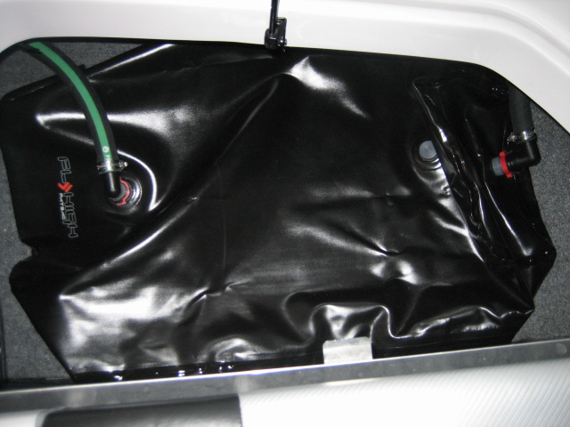

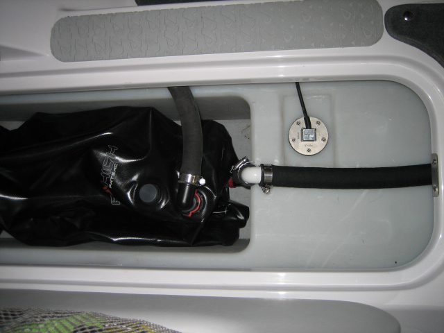

                      ? I'm confused on what you're saying there - basically I'm going to add the side sacs on top of the hard tanks (sitting on top of the carpeted partitions on each side of the engine in the pic below). I know it won't be a brick ton of weight, but I'm looking to basically have more weight in the rear since the current weight setup in my SSN is ~700lb in the rear hard tanks, ~700lb in the locker, and ~200lb in the bow under the playpen - so I am thinking that by adding the bags on top of the rear tanks that will bring me a little closer to the 40/60 ratio (so ~950lb in the front, and ~1250lb in the rear with the side sacs added to the back).
                      And I don't have the OEM tanks in my boat, they were added in after the fact, so they are rectangular in shape.
                      I also don't have access to the boat since it's up at the cabin right now, but I would think that the space between the rear tanks and the hatch is about 12", no?
