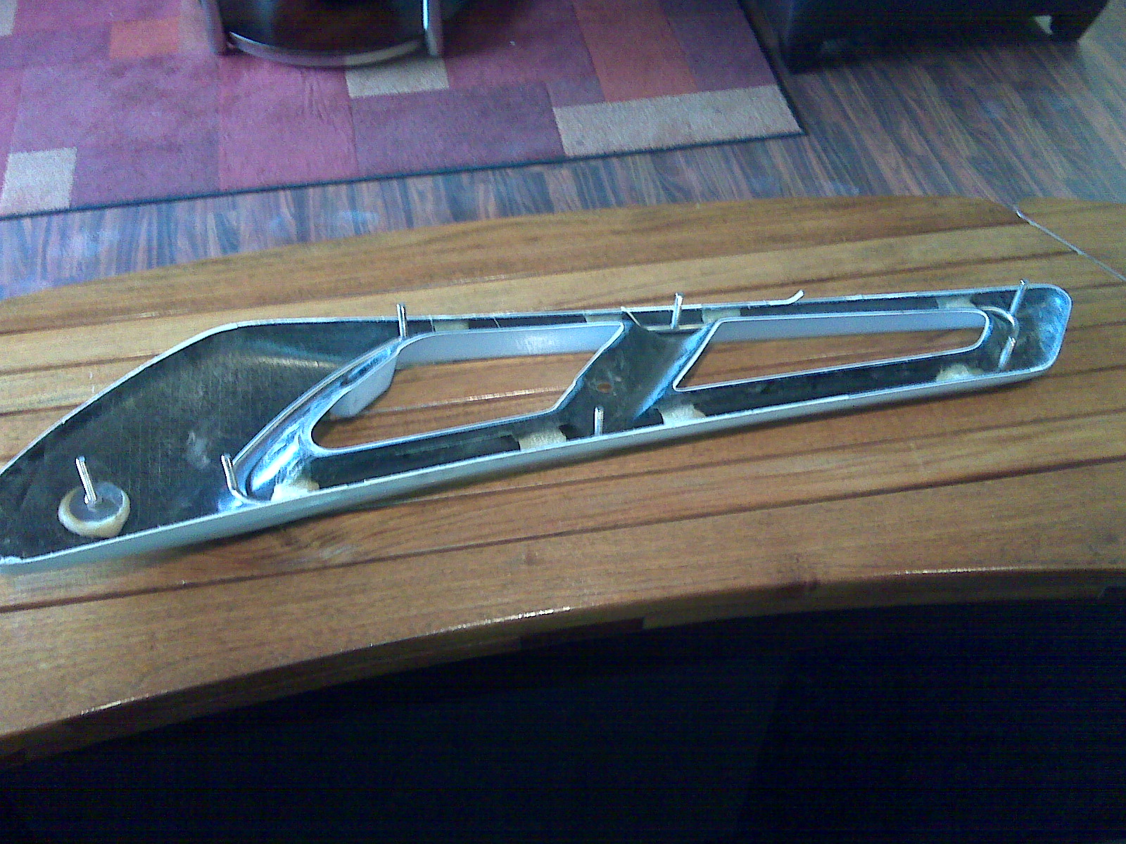

Hey Guys! Just trying to finish up some winter projects before the boat hits the water and I have been trying to find out how to remove the rear side vents and covers on my 08' 210. I know a couple of people on here have painted them like I am going to do and a couple of you have chormed them. The picture below is one of the vents in question. Can anyone help me with the process it takes to get them off, how they are attached, and how I need to reattach them to the boat without tearing anything up. Any help I can get is appreciated! Thanks!
I replaced my vent on a 236, which looks to be the exact same style. Basically, it is 4-6 bolts that are held in place. I had to remove a small panel that was held by plastic push pins(automotive interior type). With the panel removed, I had access to all the bolts. With a socket all the bolts can be removed. Lots of exposed metal so be careful. My arm looked like a cat got me after I was done. Next, take a straight edge razor and carefully cut the bead of caulk and the whole unit will come off. Should take no longer than 30 minutes each side. Good luck!
Cool! Thank you guys so much. Actually I am going to paint them black...but I have a little something else in store for the boat. I will deffinitely post pics when I am done. Hopefully, it will all be done by the end of the week. One last question for you all. I know the black flat panel comes off to "expose" the vent and bolts, but does the entire black box the panel attaches to, come off? And last one, but what kind of caulk did you use to reattach the vent? Again thanks guys and I should have pics soon!
No, the box is glassed in. The tail bolt is on the outside of the box everything else is on the inside, hence you getting your share of fiberglass in your arm from removing them. We don't put any caulk on them when re-installing them. IMO it looks better without.

Well the vents came off last night. It was actually pretty simple once you get in there. I was a little intimidated going into it but you guys instructions really helped. I just dropped them off to my paint guy and he said that I should have them by Friday. We'll see what she looks like then...along with everything else I have done.
