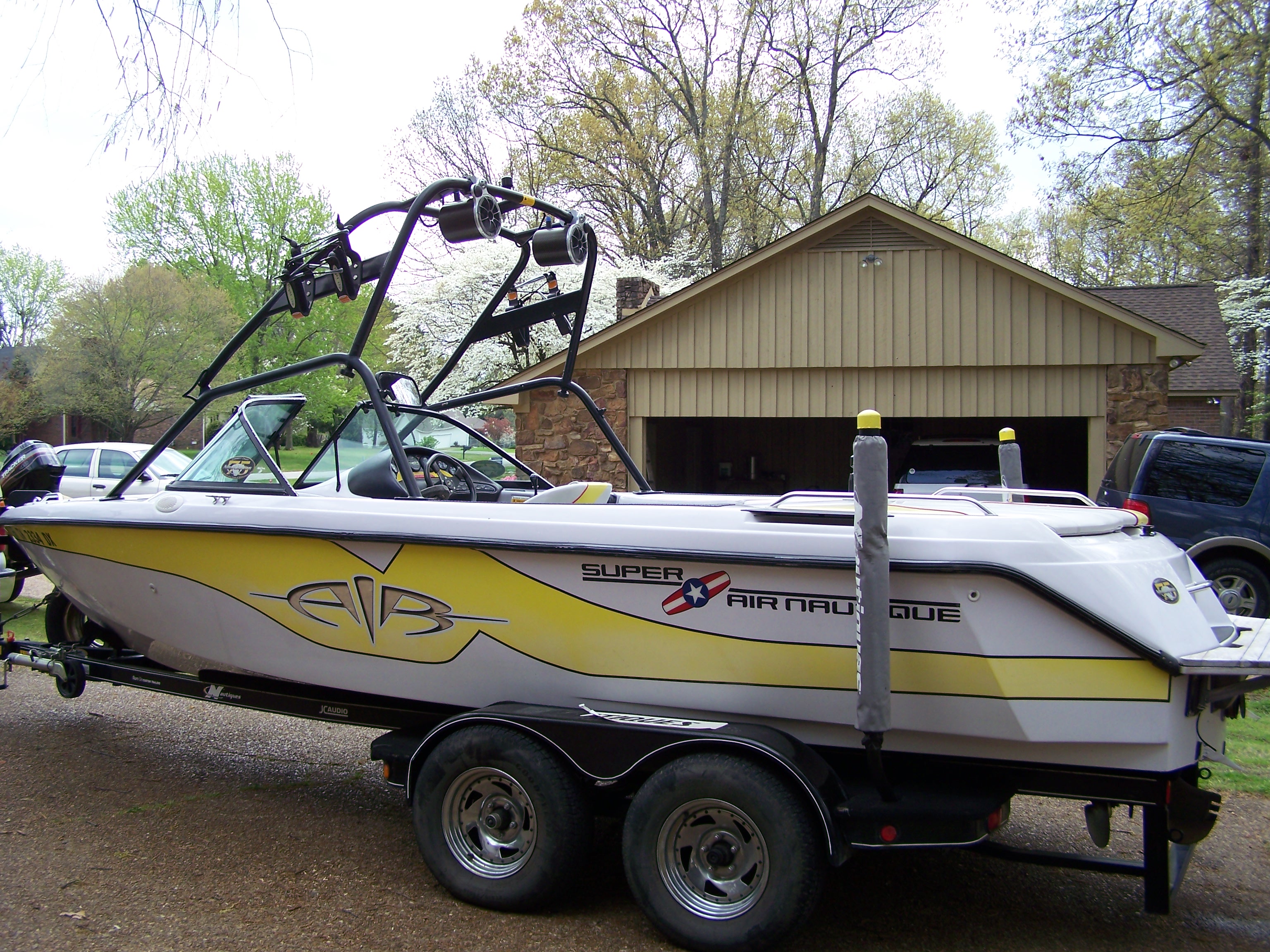

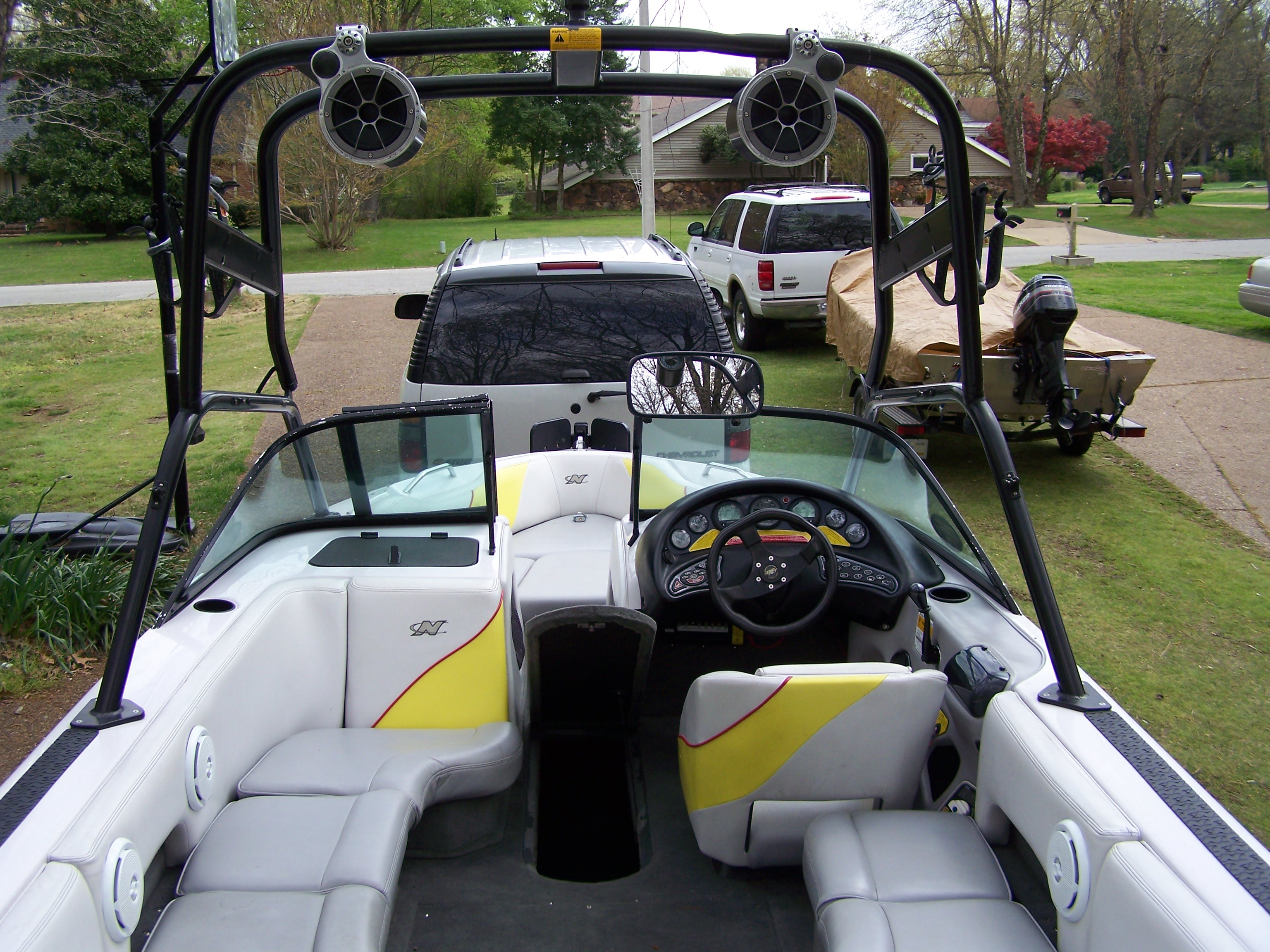

I just got this boat today and it came with the 2 stock hard tanks. Can someone give me some ideas on how much more wait I should add in sacs and where they should be placed. I don't do any wake surfing just boarding.
