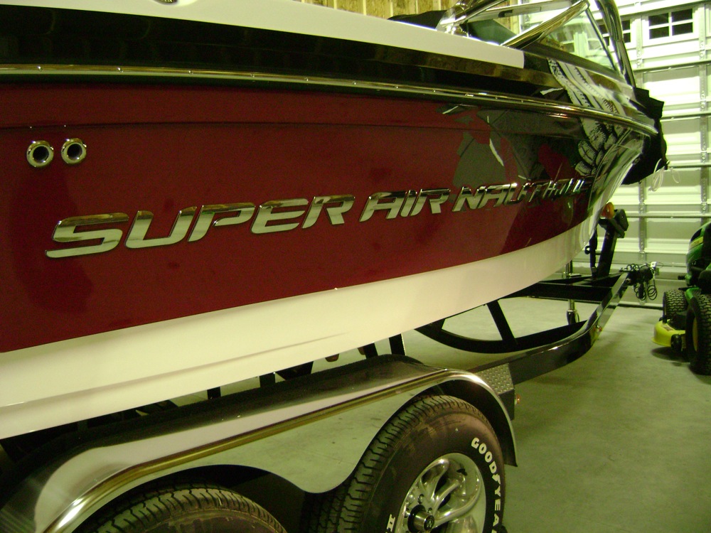

My new 210 came with the wrong SAN graphics so I had to remove the existing white letters and put these on. I marked the left, right, and top edges of the existing graphics with painter's tape. Used a heat gun to remove those to keep the glue on the decal when peeling up rather than on the boat. Used rubbing alcohol and warm water to clean the area and finally laid the chromax letters down using the tape markers at guides.

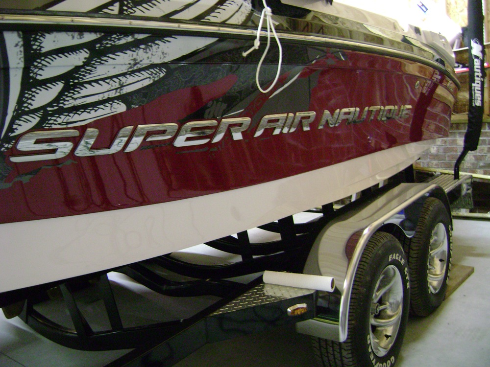

These chromax letters are pretty easy to apply because they can't bubble. They are very adhesive so you must get them right the first time b/c it would be difficult to reposition once they stick. One side comes in two pieces. Super Air on one and Nautique on the other.

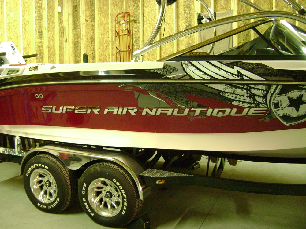

I think these change the look the the boat quite a bit. If anyone else out there is considering these for your boat I highly recommend.
