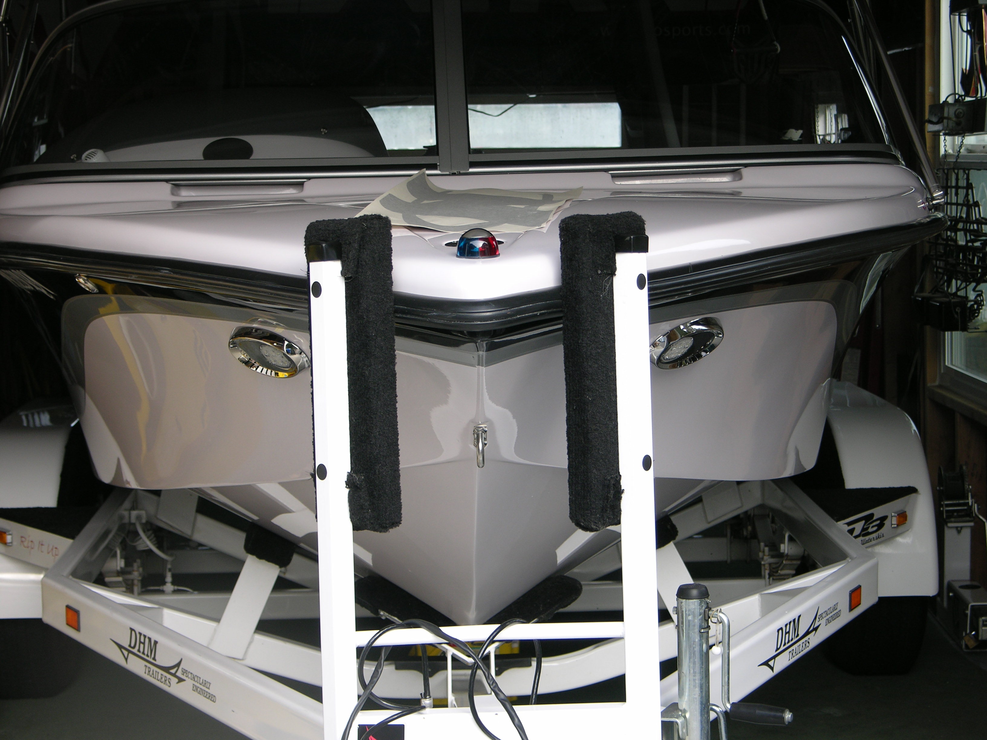

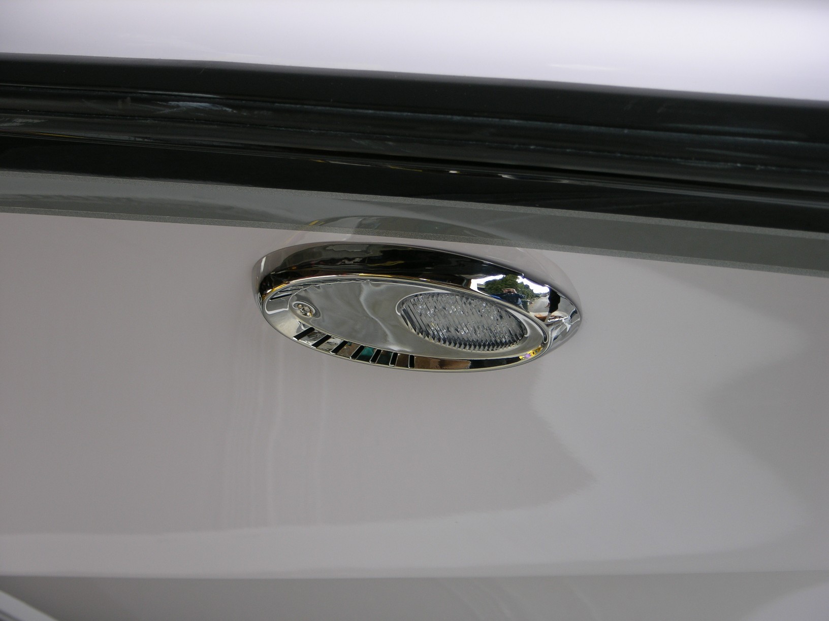

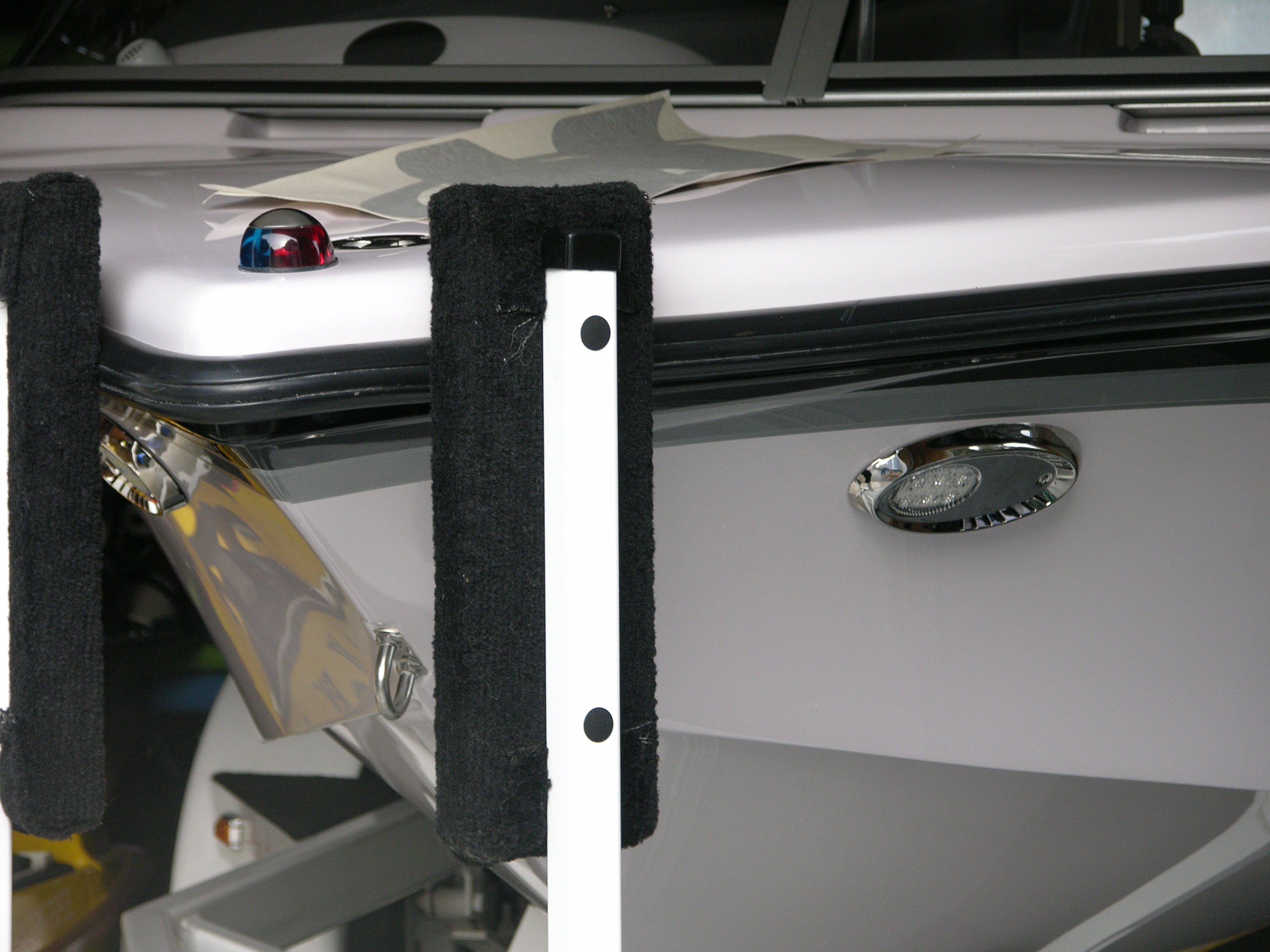

      I installed these on my 196, they're from Attwood and the only holes are for the screws, being LED, they do not need that large hole for the light. They are very bright and have a very small power draw compared to the halogens. Easy to install also. The light beam is a wide angle pattern, not a spot beam and does do a good job lighting docks, other boats or objects in close proximity, say 20 - 25 ft. The light beam or pattern is not adjustable or aimable, would be nice if it had this option, not sure if the halogens do or not. I like these over my buddies traditional docking lights he has on his SANTE.
