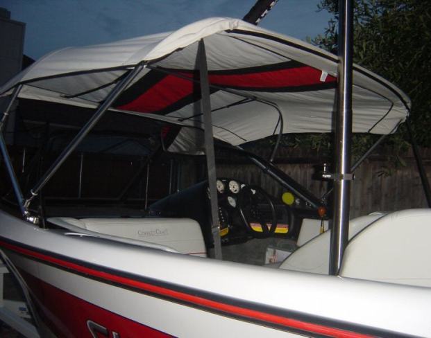

    The top on my 98 is mounted through the foam insulation under the windshield. On my last boat, the top was mounted a bit higher on the frame. When mounting on the frame, clearance between the frame and glass is key. Get too close and you're spending big bucks on a new windshield pane. Here's a picture of the top on my 98.

        Let's try this.
        • harddock
          • Apr 2008
          • 292
          • toontown E-9
          That's exactly where I was planning. thanks again, Nice top. where did that one come from?

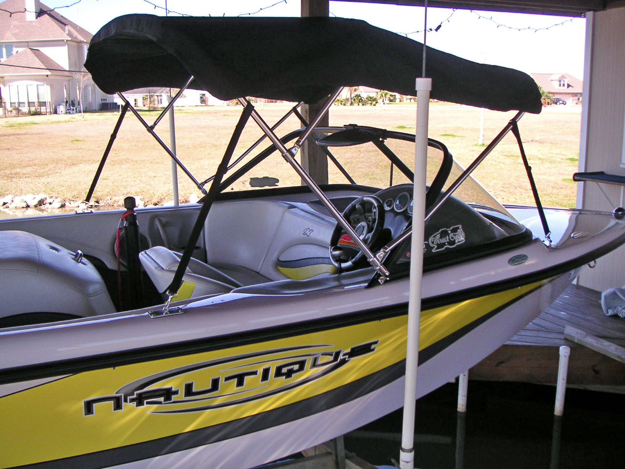

              Here is a pix of a GMI top mounted on a 2002 SN. Windshield side mount brackets are screwed on angled frame. The stanchions are cut to lower the top. It has all stainless connectors. The aluminum tubing is starting to show minor scaling after 2 years. Fresh water use only.
              Note the strap tie down brackets are custom made to cover holes from a wake tower that previous owner installed. A friends did not want to drill into gel coat for his bimini and put the mid-ship strap brackets on the floor board and the bow strap brackets into the black plastic air scoops just in front of the windshield.
              When not in use I fold it toward the stern or remove it. Black top is cool despite initial hesitation that it could be too hot in Texas sun.
