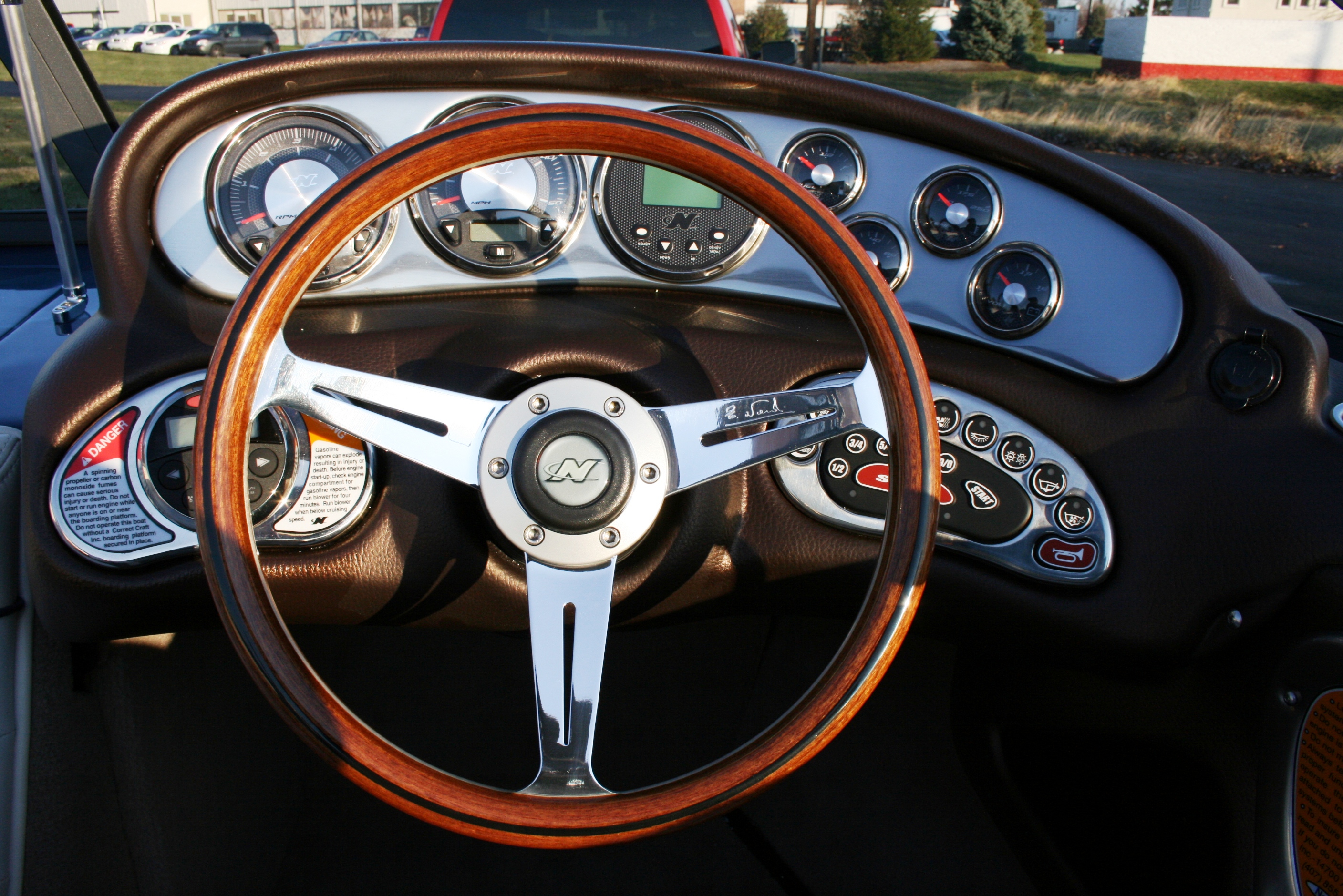

Just wondering if anyone has changed their steering wheels? If so what kind, brand and pictures? I am looking to change it for something a little nicer.

I can get you a picture tomorrow but I have a dino marine one on my boat. It was an ebay purchase last spring. Dino marine was oem for a number of years so quality is pretty good.2001 Super Air Nautique

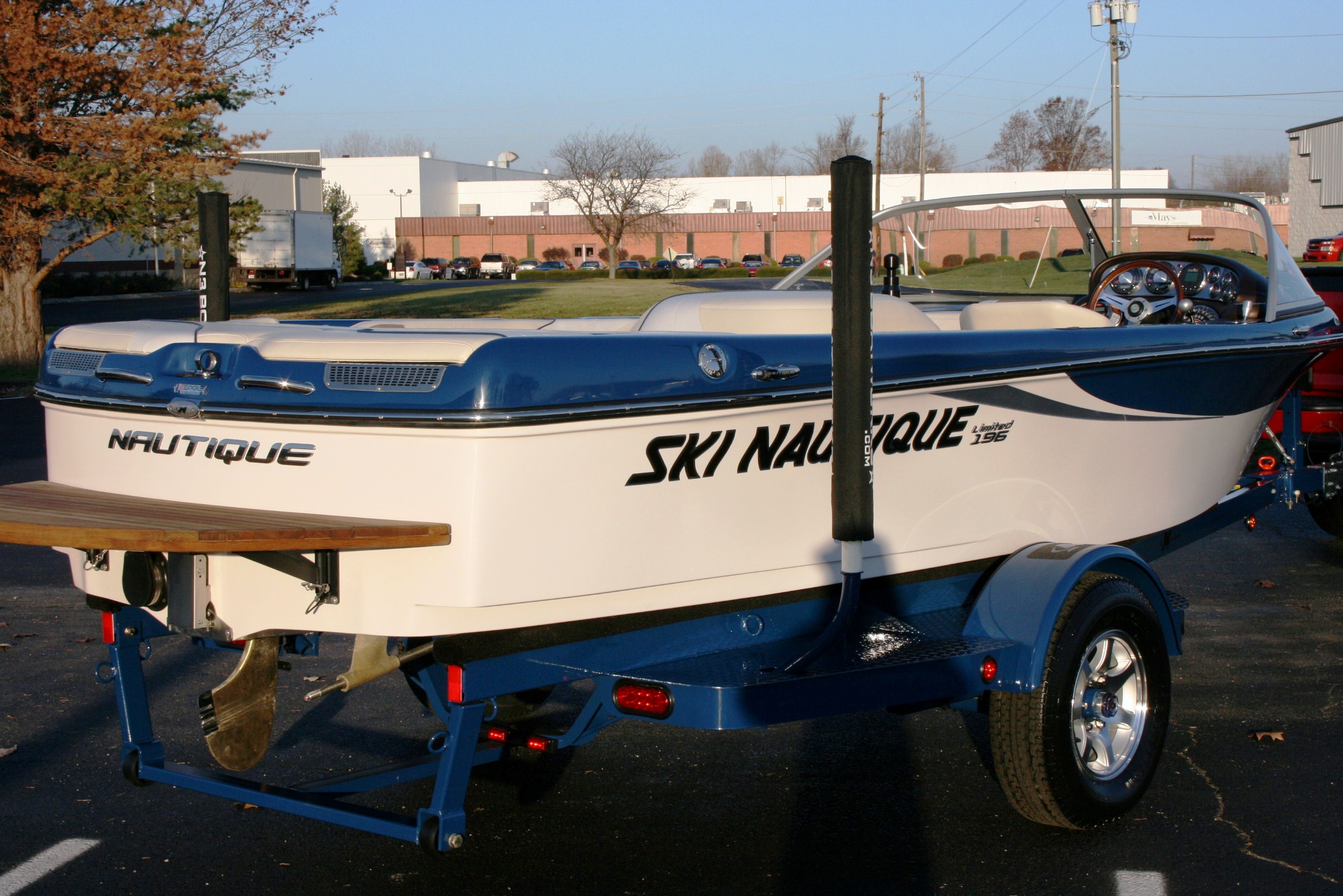

Just curious about your photo; why no propeller?

One of the biggest selections is Dino. I believe they are or at least were the original supplier for the burlwood steering wheels used by Nautique. If you hold yor mouse over the pictures, one is model 82B - that is the wheel on the 99 models (my boat), but in burlwood.
http://www.dinomarine.com/06 Ski Nautique 196 SE (2010)
99 Sport Nautique / GT 40 / FCT (2005 - 2009)
When searching for a new steering wheel, be aware that you need one for a splined shaft. Most marine wheels out there are for tapered shafts and they will not work. Also, the bolts you see on the hub just hold the cover to the steering wheel hub and are not required on a new wheel...just a CC design element.
