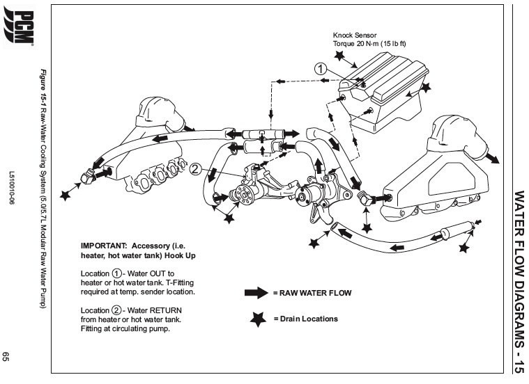

I decided to go ahead and winterize my boat. It is an 06 210 nautique with the 5.7 liter excalibur engine. I just wanted to make sure that I am not forgetting to do anything. I read through most of the manual but wanted to double check that i got it right. I think i got everything drained that is shown on page 65 of the owners operational and maintance manual showing the raw water flow with drain locations.
1. I added fuel stabilizer and Fogged the enginge.
2. Removed the 2 drain plugs from the block.
3. Removed 2 big brass plugs and drained water from the exhaust manifolds.
4. Removed the Raw Water Plug from underneath the transmission.
5. Removed and drained plug from the circulating Pump.
6. Removed the hose that runs to the Raw water pump assembly and drained water from a plug that i think would be the oil cooler. Not sure what it is called. It is connected to the same hose that i drained water from which hooks to be the Raw water Pump assembly.
So that is my question #6 Do i have a heat exchanger that i still need to drain and did i drain the oil cooler?
I also drained the water from the strainer. I then ran antifreeze through the boats water intake hose until it started to come out of the exhaust. I also drained the antifreeze from the strainer.
Is there Anything else I might have missed or that you would suggest doing before storing the boat for a couple of months in Utah?
I still need to pull out the impellar and probably replace with a new one.
Thanks for reading this long post. The people and posts on this site have been very helpful.
