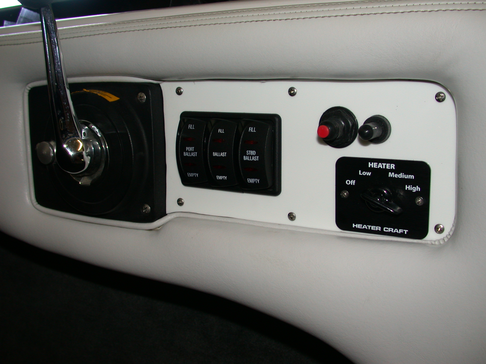

    I put the ballast switches on my super sport where the capacity plate went as well. My plate now sits in my glove box.

          Here are my switches......

            That is exactly where I am going to put mine. I am going to put them in a black panel though. I am going to use the factory style circuit breaker and light so it looks even more factory. I actually found a carbon vinyl that looks similar to my dash but might not do it.

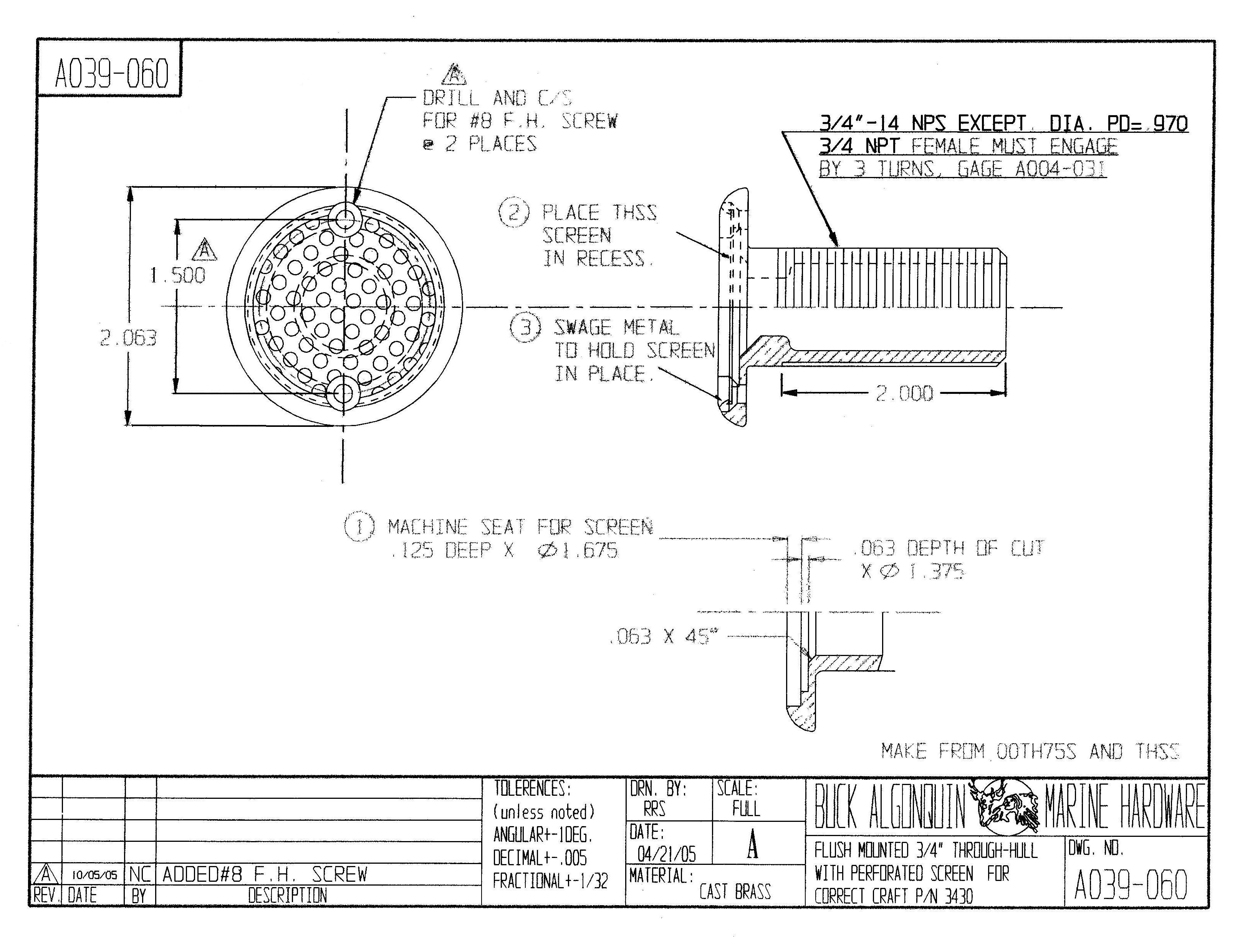

              Bchesley, are the ball valves pipe thread or straight thread? I have the same thru-hulls as you from CC and they have a 1x14 thread. I can't seem to find a ball valve that isn't NPT.

                You know I am not really sure. Mine are all factory parts. I never even thought to find out what thread they were since I ordered them as an assembly of thru hull - valve - hose barb. The 1"x14 though is misleading you, as the size designation for parts of pipe is ID. That is really 3/4" hardware. Can you take it to a lowes or home depot and test fit some pieces to make sure of what you have?

                  wake_fun...any trouble with the throttle hitting your switches when in reverse?

                      #40
                      My throttle does not hit at all. The throttle is a lot further out, remember the throttle is out past the vinyl padding.

                          I also have those thru hulls. I bought my ball valves at home Depot 3/4 NPT

                            MNSuperAir: I went round and round about this as well. I have the same thru-hulls and went to some supply shops and Home Depot/Lowes. Never could seem to get anything to screw on without binding. Contacted Buck Algonquin and here was there response.
                            "The threads on a thru hull are a straight pipe thread and the threads on a valve are tapered pipe thread. It is natural for the valve to thread on 3-4 turns, and then tighten up. That is standard in the marine industry. Keep in mind the application of the valve to ensure you are using a marine grade valve that is better suited against corrosion. My 00BBV75LP will fit properly. Please let me know if you need more information. ".
                            Also, learned there is different types of brass. I was looking at the low cost of a Lowe's or Home Depot ball valve ($9 bucks a piece as opposed to $27 or more for marine store versions). Learned that there is yellow brass and red brass and most low cost (Home Depot etc...) is yellow brass and more open to corrosion. Stuff you get at West Marine or Marine stores is usually bronze or red brass. Would you have to worry? Probably only if you were in salt water conditions.
                            Here are the specs on the thru-hull. Use #8 half inch screws in screw holes to hold in place.
