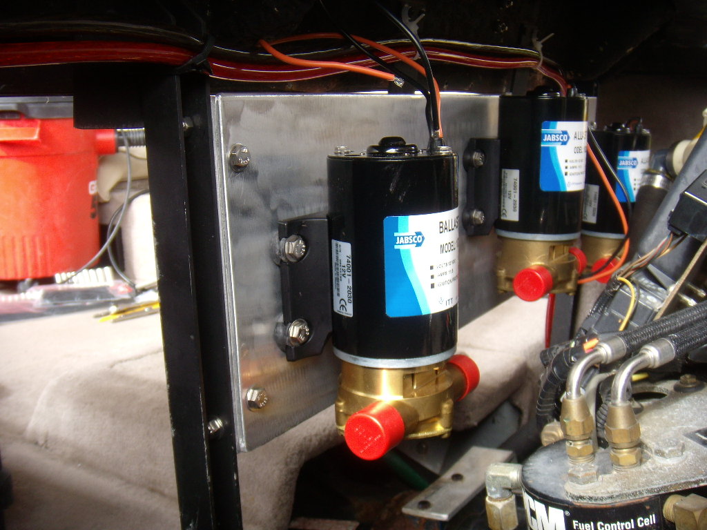

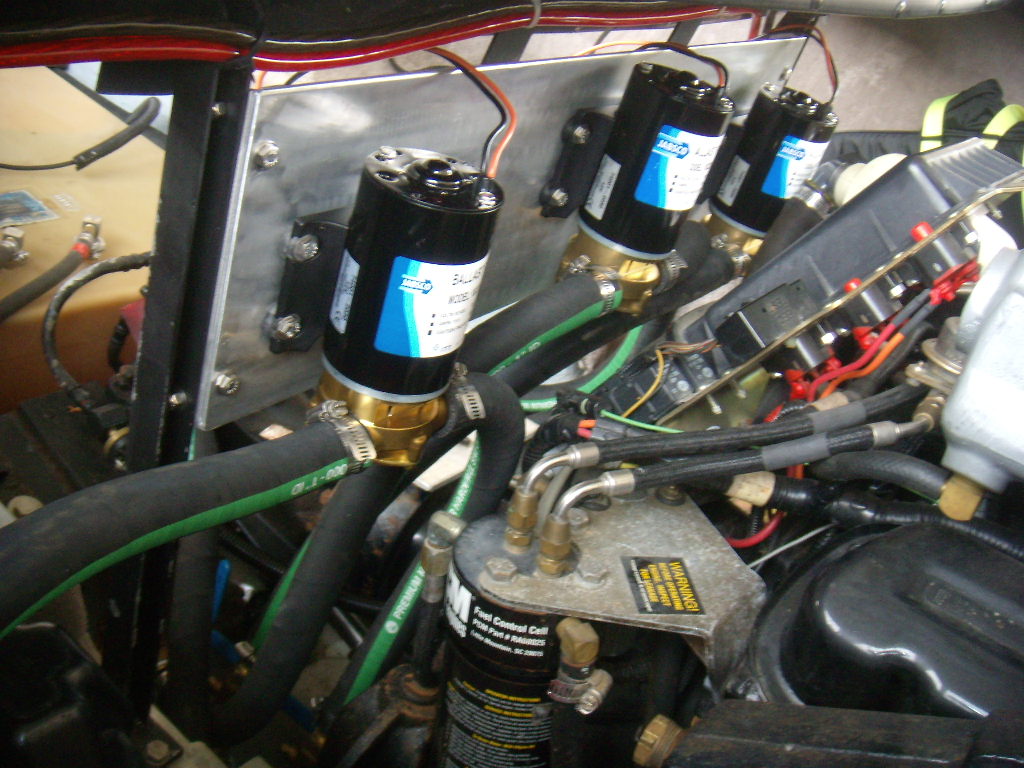

              I finally got around to mounting the pumps and running all the hose for the bags. All that is left to do is to wire in the switches. I am still unsure how and where I want to put them. I want them easily accessible for the driver but as close to the pumps as possible to cut down on current loss and wire expense.
              The panel that I mounted the pumps to is 8" tall by 28" wide. It is 1/4" aluminum mounted to 3/16" by 1" angle. I used all 1/4" stainless steel screws and washers.

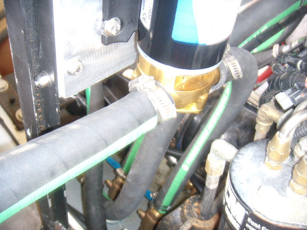

              I ended up using the wire reinforced hose that the new boats come with. After pricing the white reinforced hose I found the factory was just a few cents more per foot. I also thought that someone at correct craft felt it was necessary I should use it. I also have always taken the stance that any add on or accessory should be of the same quality and craftsmanship that CC would have done.
              I cant wait till spring now. I am hoping to at least test fill and empty once this winter to see how fast it works. I am going to order my wire next week so maybe I will get the switches wired soon.

                Sweet, dude. Nice mounting job. May make access a little tougher to some some spots down there, but looks great.
                I would just run the wire up front to the drivers seat. You don't lose enough current to concern yourself with, and the bulk of your cost is already installed. I mounted a little plate below my throttle. It is an ok spot, but could probably have done better. If you do not have the original ballast system gauges, you should have a spot there. Z put his there; they are accessible, and look really good.

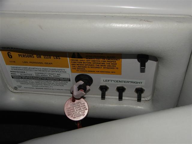

                            • Sinkoumn
                              • Jun 2006
                              • 578
                              • MPLS - St. Paul, MN
                              • Super Sport Nautique
                              #29
                              Here's how I did mine, and kept the plate - there are four (3-position) switches (port/starb/belly/bow) and they all fit fine. They are switches that you can get from any Malibu dealer (I actually bought the 4th one (for the bow sac) online and had them ship it to me - super easy).
                              You can free up a lot of space by relocating the emergency kill switch by simply just mounting it on the inside of the gunnel - that way the lanyard can still be connected to the driver if need be.
                              This picture is old, but I added the fourth switch right above the white label. The lift hatch switch is still in the upper right corner of the plate.
                              [url=http://www.neustonboards.com][i][color=Blue][size=4]Neuston Boards[/size][/color][/i][/url]
                              [size=4][i][color=green]Nautiques[/color][/i][/size]
                              • gride300
                                • Apr 2008
                                • 1356
                                • mobile, al
                                #30
                                i like the left, center , right for non agua lingo speaking folks who might be at the helm.
