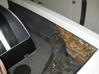

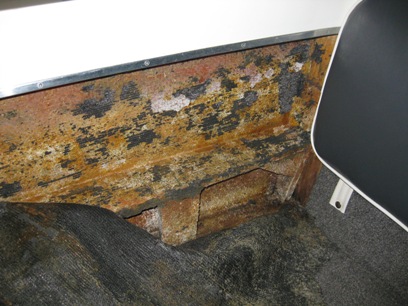

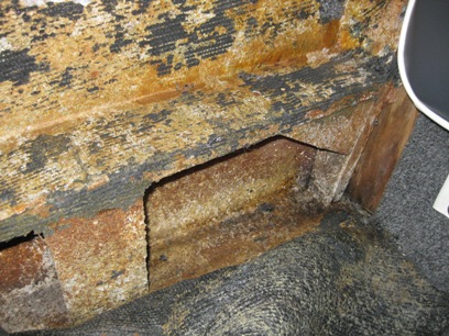

Ok, not sure what to call it and searched for a previous thread but couldn't find anything. I want to remove the ski locker on the starboard side behind the driver to allow room for fat sacs next to the engine cover. Last night I removed all of the screws and explored under the carpet. I found that I have enough carpet to remove the wood and re-glue without having to re-carpet (i plan to re-carpet this winter). My question is: I'm not sure how the wood attaches to the hull. Is it fiberglass? It looks like foam. I tried scoring with a blade, but figured before I got too deep into this project I would ask someone who has removed theirs. Any help would be appreciated.

It's just glassed in, you can cut them out with a rotary cutting wheel in a dremel, just be careful not to cut too deep , too agressive and your through the side of the boat.

thanks, figured it out this weekend.

As for cutting the glass, i scored mine with a utility knife about a dozen times before it was weak enough to remove. It was actually easier than using a grinder or cutting wheel. I then used a sharp chisel to smooth down the leftover glass.
