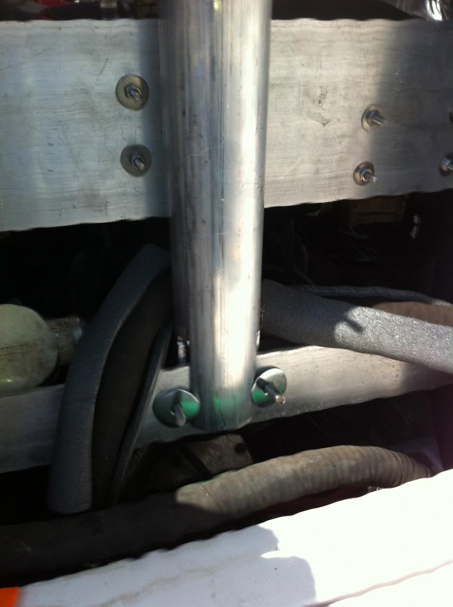

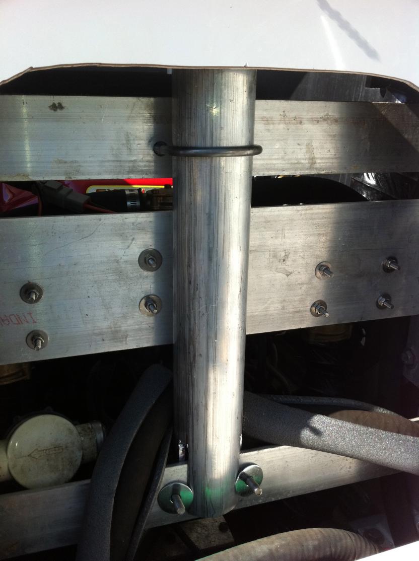

    I will get some dimensions when I pick up the boat from storage
    Here is a thread we started a while back: (not sure how to link it)
    Can a 220's ski pole be converted to a pop up?
    There are pictures of my homemade version near the end of the thread.
    It is mounted with u-bolts to the aluminum frame that the original pole was secured to. I have no way.....yet.....to pull it up other than open the engine compartment.

        Thanks One thing I noticed it that if the OD of the tube grows it needs to span the lower L bar at the are not planar from a top down point of view. Do you know the dimensions of the Tachyon Pylon's OD?

          Yes, the Tachyon Pylon OD is 2.5" for the 'tube', and the pylon itself is 2" diameter. The bottom of the 'tube' is designed such that it allows the standard 2.5" U-bolt (which is a 2" diameter on the ID) to clamp on the bottom.
