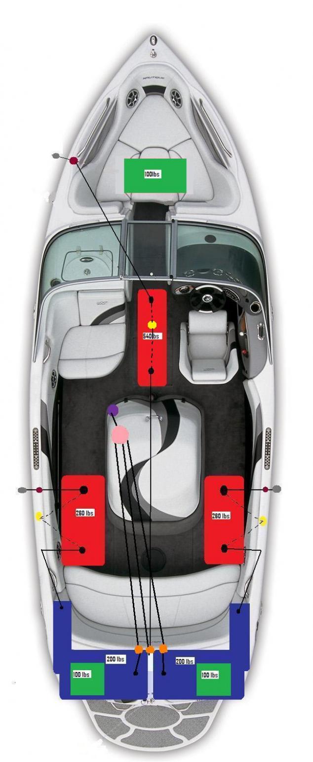

          Blue= Existing ballast
          Red= Additional ballast
          Orange= Jabsco rev. 1123's
          Green= 100lbs. tractor weights
          Purple= Thru-Hull intake
          Pink= Manifold
          Yellow= Quick Connect spot
          Maroon= Non return check valve
          Gray= Thru-Hull outlet
          1. I have the 3/4" thru-hull intake and I'm thinking about leaving it at that and just getting a up size fitting to 1" to feed the rest of the system.
          2. I would like to build a 3-way manifold that goes into the ball valve so i keep just one intake.
          3. I'm going to mount the pumps in the rear hatch.
          4. Going with 1" hose.
          5. Putting non return check valves on all outlets.
          6. Building a sub floor over the hard tanks for the tractor weights
          Here is the parts list i have started.
          Plumbing
          60' - 1" hose
          3 - Jabsco 1123's (orange dot)
          3 - 1" thru-hull outlets (gray dot)
          25ish - 1" hose clamps
          3 - non return check valves (maroon dot)
          2 -Fly High 746's for the ski locker sac (red ski locker)
          2 -Fly High Launch Pad 3/4" thread adapters (red ski locker)
          6 - Fly High 748's for the bypass on all sacs (yellow dot)
          6 -Fly High 743's for each sac (red, ski locker & sides)
          4 - Fly High 741's for the 2 side sacs (red side sacs)
          2-4 1" hose barbs for the hard tanks (blue)
          I may take out the 3/4" thru-hull intake and put a 1" set up in there.
          I'm still thinking on how i want to make my 3-way at the thru-hull intake so i don't have any parts here for that.
          Electric
          1 - fuse box
          1 - perko switch
          1 - additional battery to the one i already have
          I'm using 4 guage wire for the battery to the fuse box
          I'm using 12 or 14 guage wire for the fuse box to the pumps
          this is what i have thought of so far. It's still cold up here in Iowa so i haven't made it into the garage yet to look deep into things.
          Any questions or critiquing just PM me or email me back.

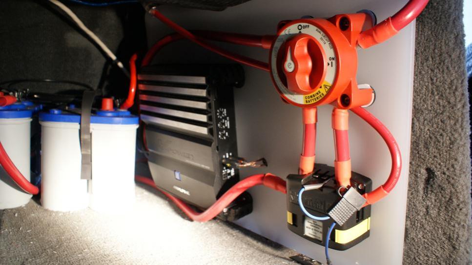

            I have 2 batteries with a Blue Seas isolator system. I have a blue seas blade-style fuse box that I will tie into my existing audio distro block. The audio distro block has 0 gauge going to it. I'll use the fattest cable I can to connect the new fuse panel to it. This is all located under my observer seat on the outside wall, fastened to a large plastic cutting board (along with my tower speaker amp).

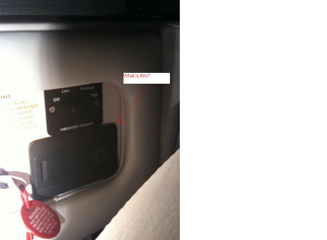

            I want to install the switches in the throttle pad, but am not sure. There is some weird lock thing (that I have no idea what it is for) that is right where I would like to put the switches (so I wouldn't have to move the coast guard plate. Genuinedealz.com for the electrical cable.
            Doesn't the glove box drain just empty into the bilge?

                            I am pretty sure the cooler drain has its own thru hull because there are three on the driver's side. One for the tanks (air), one for bilge and a third for the cooler.
                            did you move the batteries underneath the observers seat? My single battery came stock from the factory in the bow....

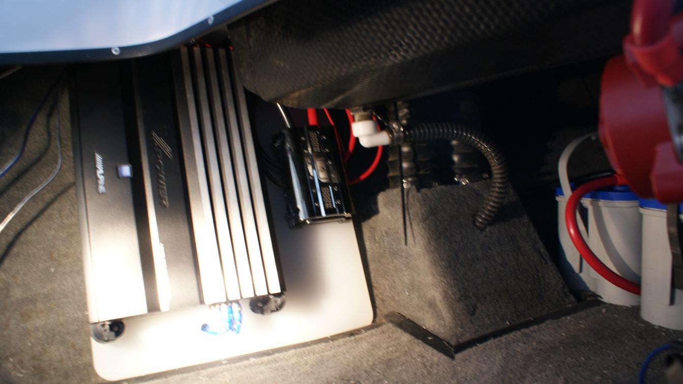

                              My 2 batteries are under the observers seat as far forward as they can go. That put them very close to my distrobution block and isolator / combiner setup. They are Optima blue tops, so they are pretty small.

                                Perhaps your cooler drain is different than mine. My "cooler" is the glove box. At the bottom it has a hole with a drain that connects to a hose that just connects to a fitting under the observer seat. The hose itself stops there, which leads me to believe there is no vent line (it's just the bilge). You can see the black tubing in the picture.
