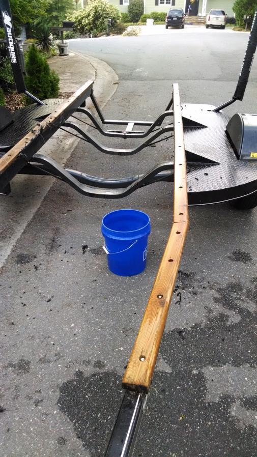

      I just redid the carpet on my trailer bunks. The bunks were pressure treated 2x4's - one side (top) had it's edges beveled.
      I'd pull one off if you're able to and start taking things apart and see how it was put together. Then you just copy the design and make a new one, assuming you're handy. That's what I did for my trailer bunks. I had no idea how it would work out, but just got into it and it all made sense when I had taken the carpet off.
