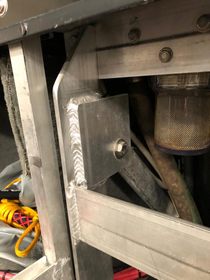

    I have been working with the guys at Nautique to try and figure out what I need to do to add a Ski Pylon to pull tubes from as currently I only have a single tow point(Roswell Aviator Pro Tower) and the folks said no go on towing from there. I don’t blame them. But now I’m trying to figure out where to tow the kids from as I don’t have the ski pylon behind the rear seats or a transom tow point.
    If anyone could post some pictures of the support structure for their pylon that would be very helpful. The guys at Nautique were very helpful but didn’t have any of the old specs of the support structure.
    Any pics would be helpful.

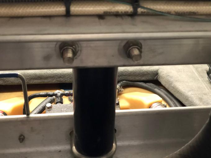

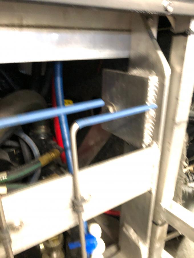

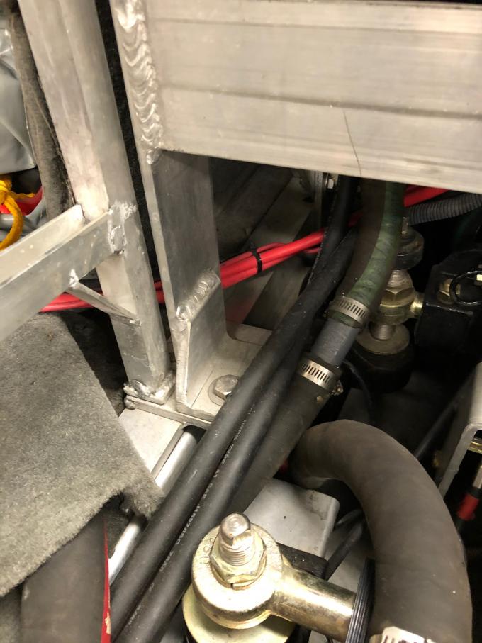

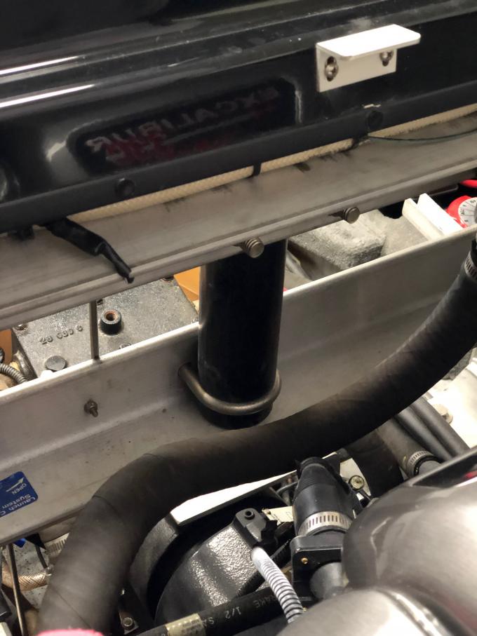

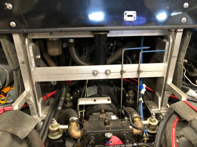

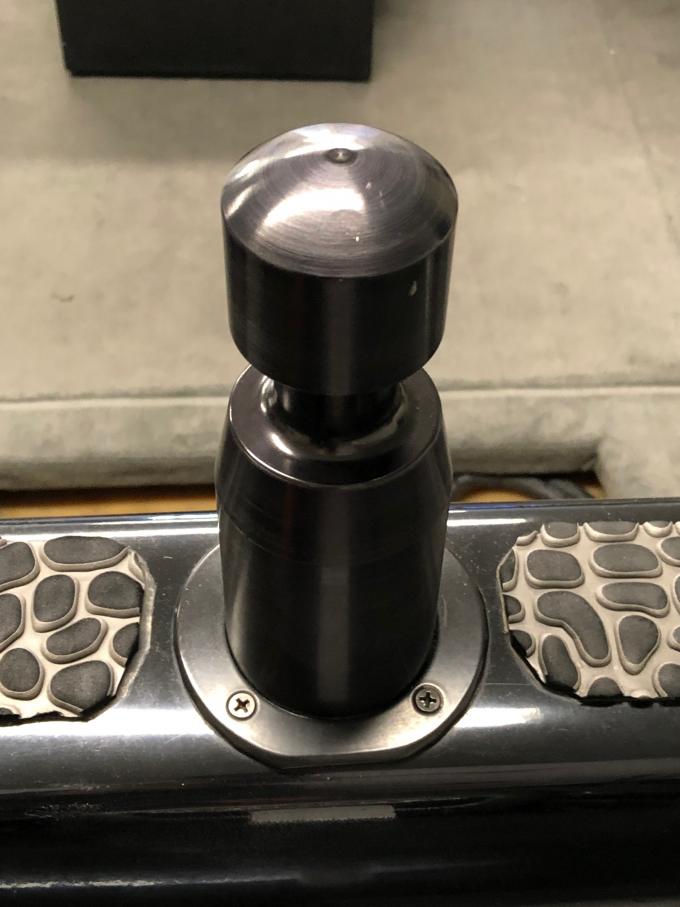

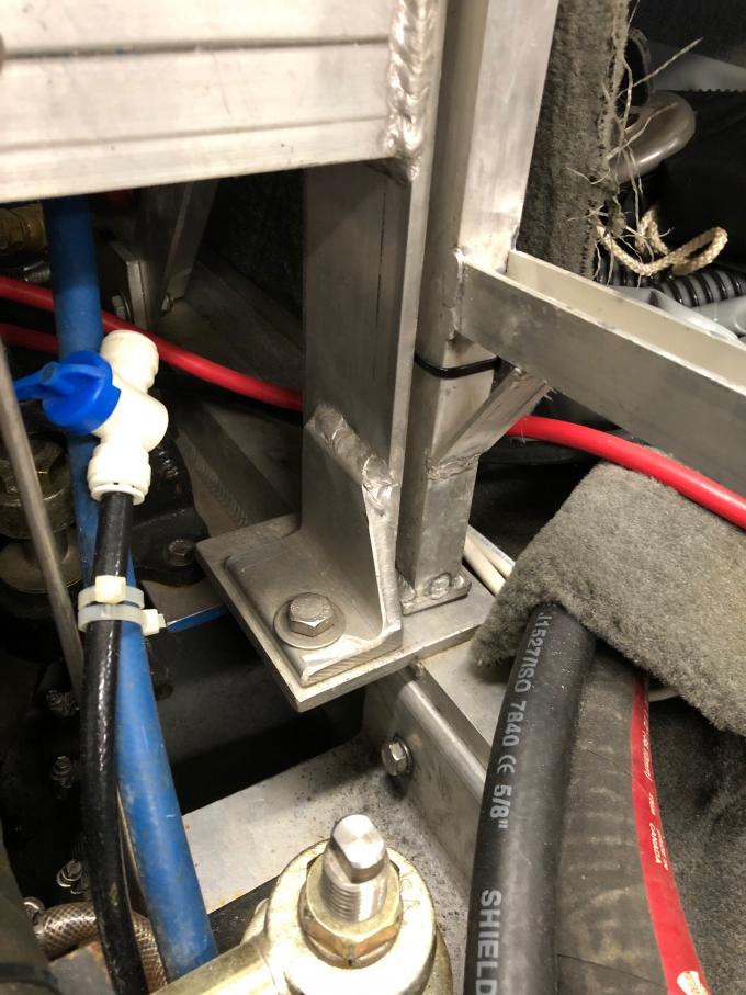

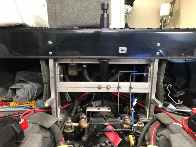

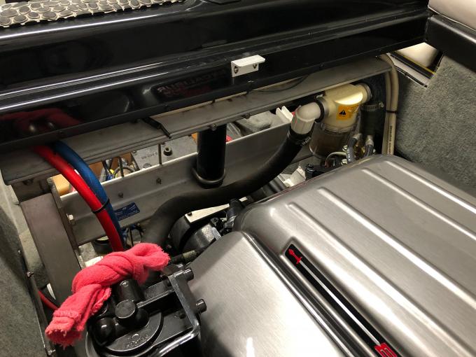

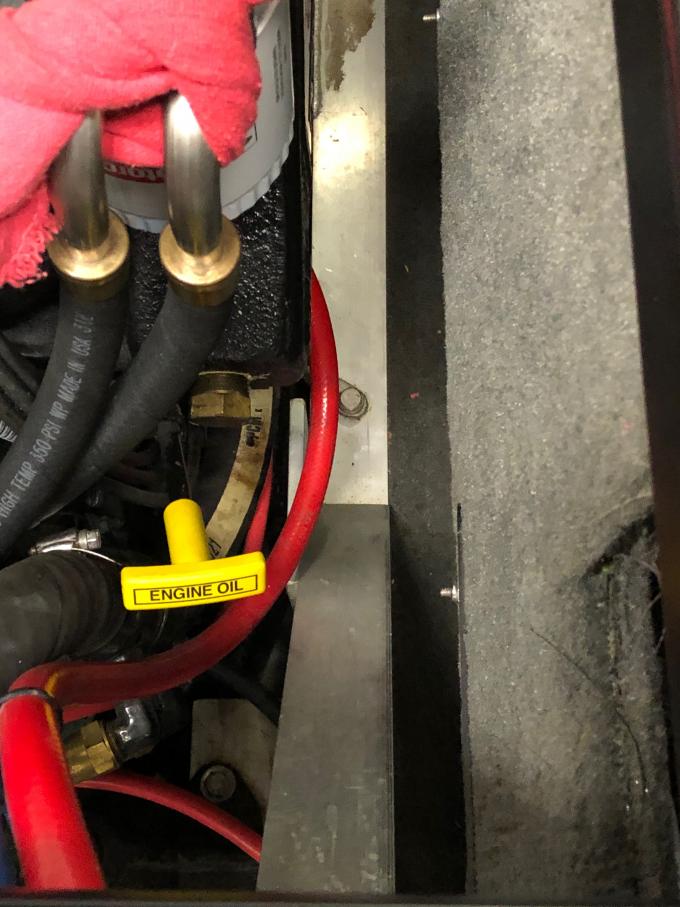

        Lucky for you I have my boat apart right now... 2003 SANTE
        Jason
        All black 2003 SANTE
        -- Southern Fried --

          Thank you!!!!!!!!!!!
          Are you able to get a measurement of the pylon itself?

            Looks to be 24" (+/- 1/2")... If you need anymore detailed pics let me know. I'll have it apart a couple more weeks I think.
            Jason
