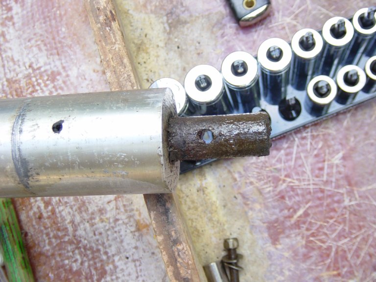

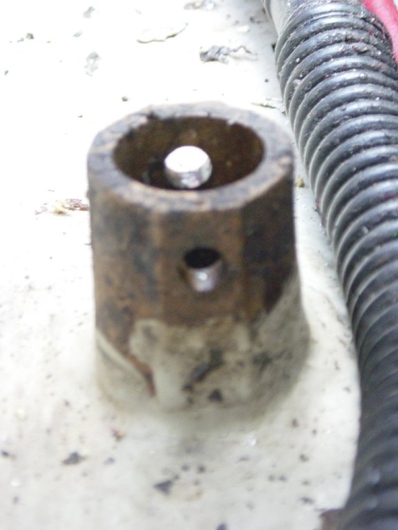

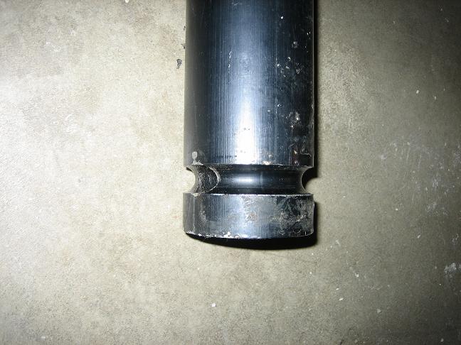

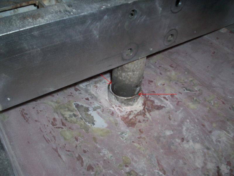

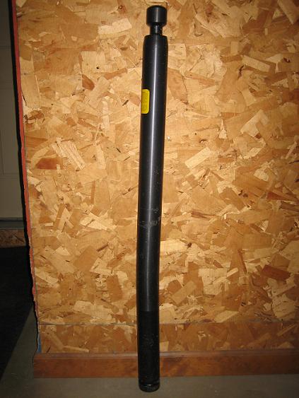

The newer ones won't bolt into the socket in the hull. It will clamp in but you would need to modify either the base of the pylon or the hull pin/socket. I may have a black teflon coated pylon circa ~95 available this winter.

Not a lot of people replace their pylon! You can have one machined quite easily, finding a shop that'll bang it out w/o charging you a ridiculous price might be the hard part. The short pylon I have that I offered is slightly bent, so I don't think it can be turned in a lathe to get the bottom to bolt up in your boat.
Did you try calling a CC dealer? The new pylons are straight all the way, you could turn down the base to fit your boat. ****, they might be willing to do it for you since I think they generally make pylons to order when needed.
