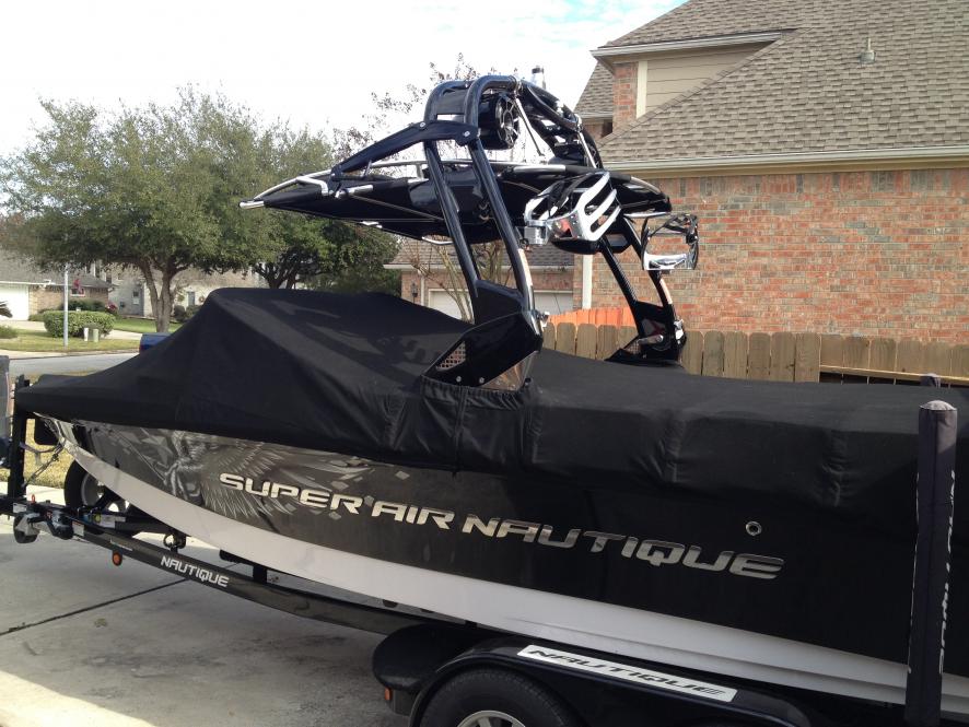

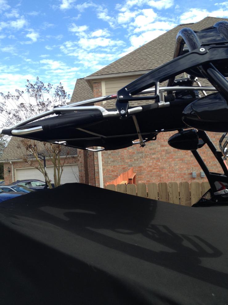

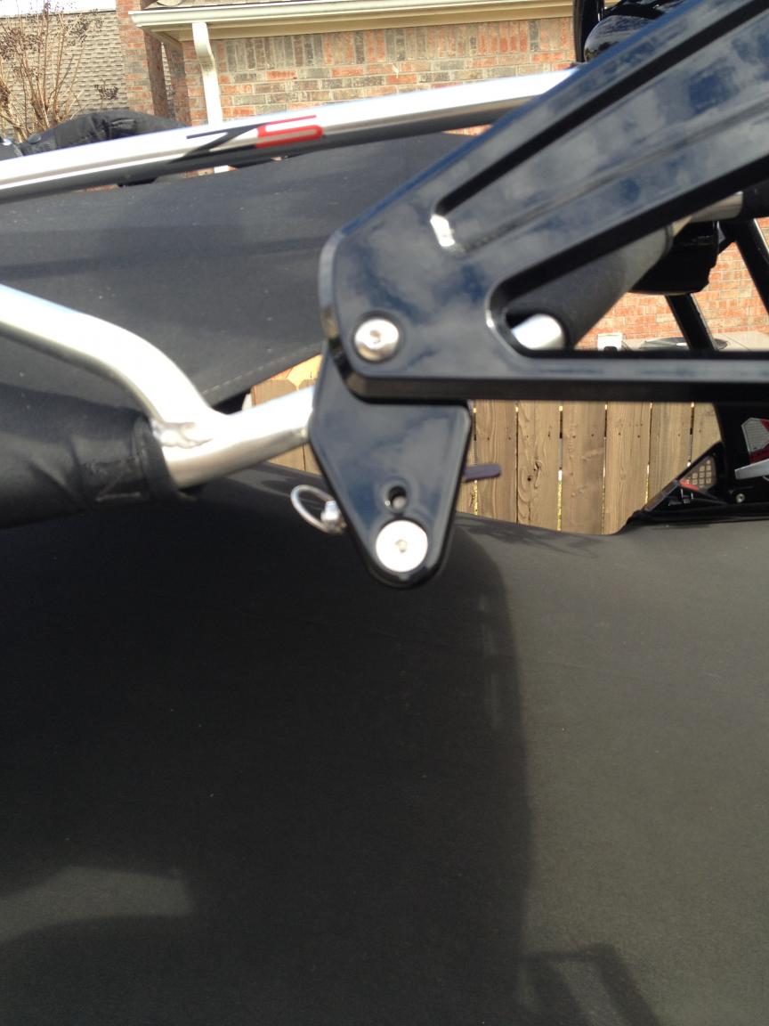

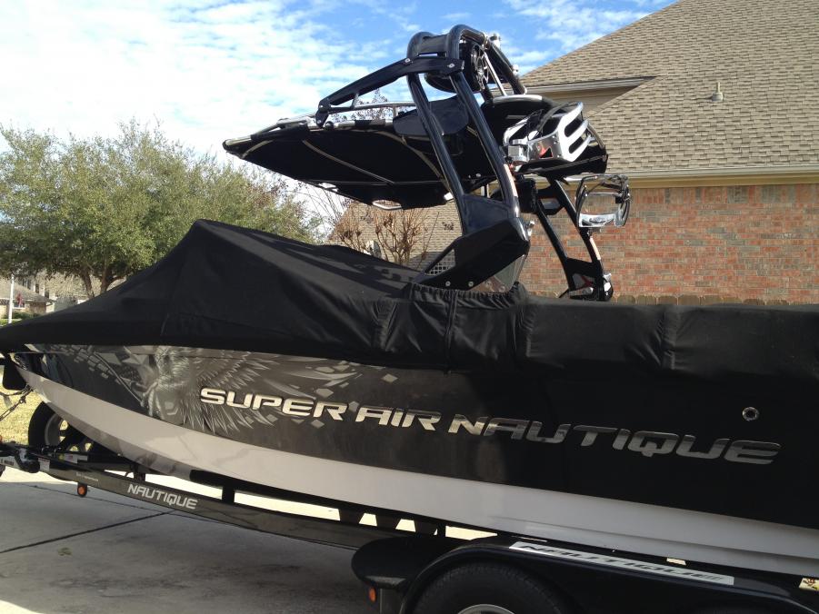

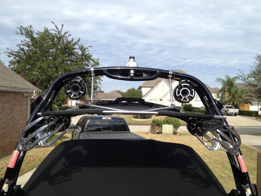

As everyone knows, the wetsounds tower speakers will not fit in the stock location if the boat also has a Z5 bimini. Z5 has come up with a great solution for the problem! They custom fabricated some front mounts and longer strut arms which lowered the whole bimini by a little over 2 inches. This way, the bimini is still level (if not slightly lower in the front) and the pivot feature of the bimini still works as well as the pivoting board racks. It actually looks a lot better than I expected it to. Here are some pics.
If anyone is looking at doing this, I highly recommend calling Z5 and have them send you out some of the lowering brackets. It is a terrific solution and very easy install.
